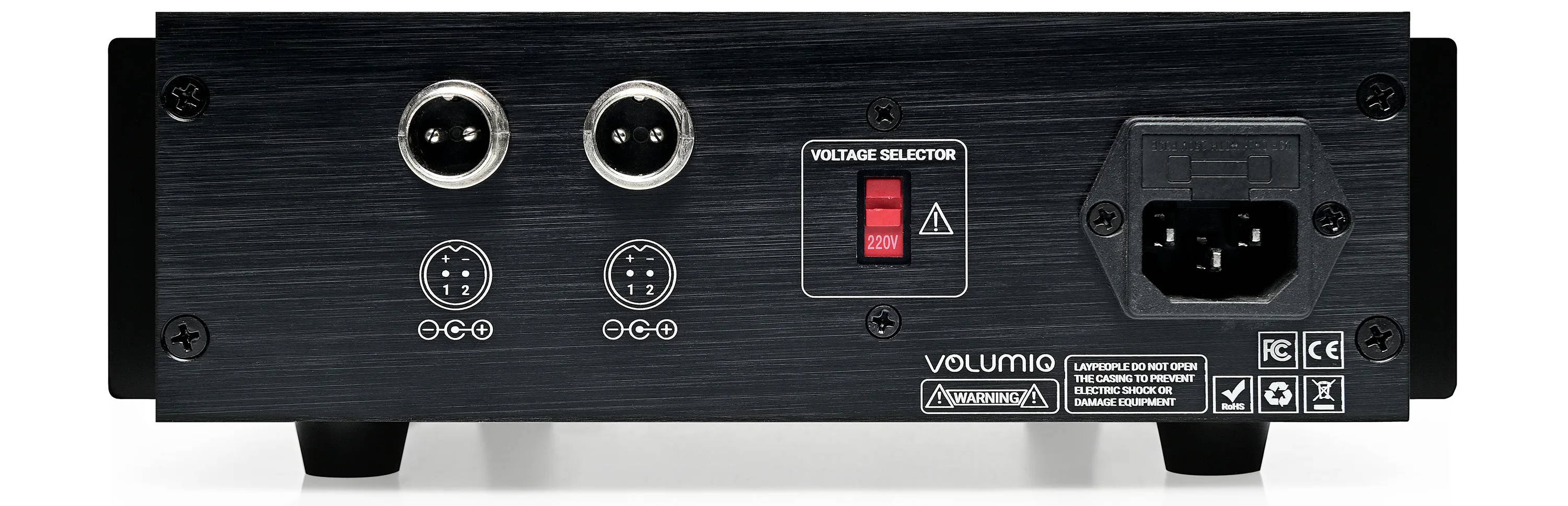

110 or 220 V
A switch on the back sets the mains input: 110–120 V at 60 Hz, or 220–240 V at 50 Hz.
An easy-to-reach fuse
A fuse protects Lineo5 Duo, and it is easy to reach.

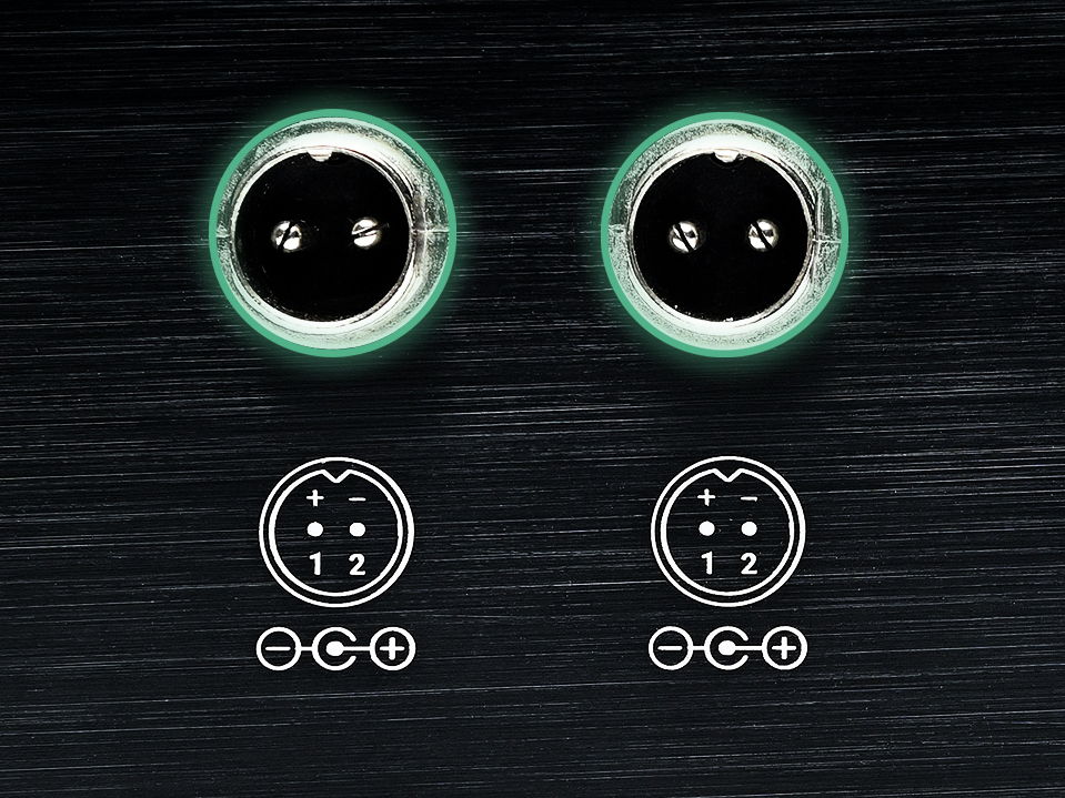

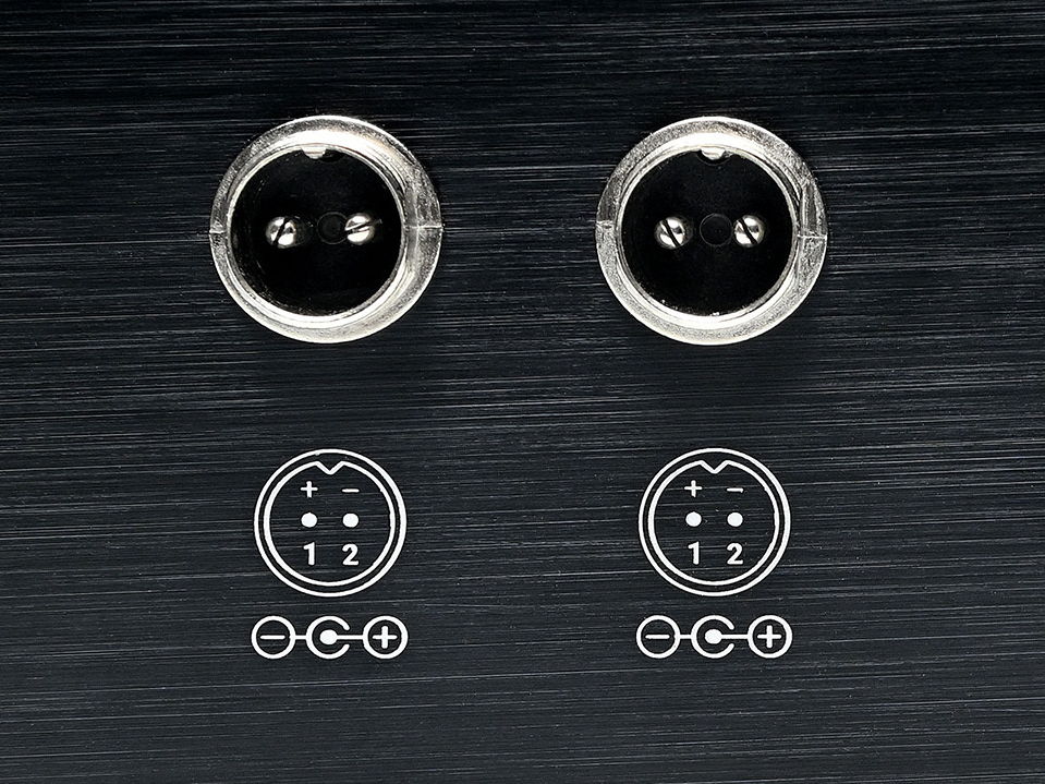

- 5 V DC, tip positive, from GX-16 sockets with 2 pins, and output cords that end in a 5.5 × 2.1 mm barrel jack. Mains input of 110–120 V at 60 Hz or 220–240 V at 50 Hz, set with a switch. A toroidal transformer, audio-grade low-ESR capacitors with 40,000 µF of bulk capacitance, filtering that reduces ripple and interference, 20 µV of residual noise, and an easy-to-reach fuse. An aluminum chassis with heatsinks, 27.1 × 22.7 × 7 cm. Compatible with the same devices.

- Connectors
- GX-16 (2 pins)
- Output power cord
- GX-16 (2 pins) to barrel jack (5.5 × 2.1 mm)
- Output cable length
- 115 cm (45.3 in)
- Output polarity
- Tip positive
