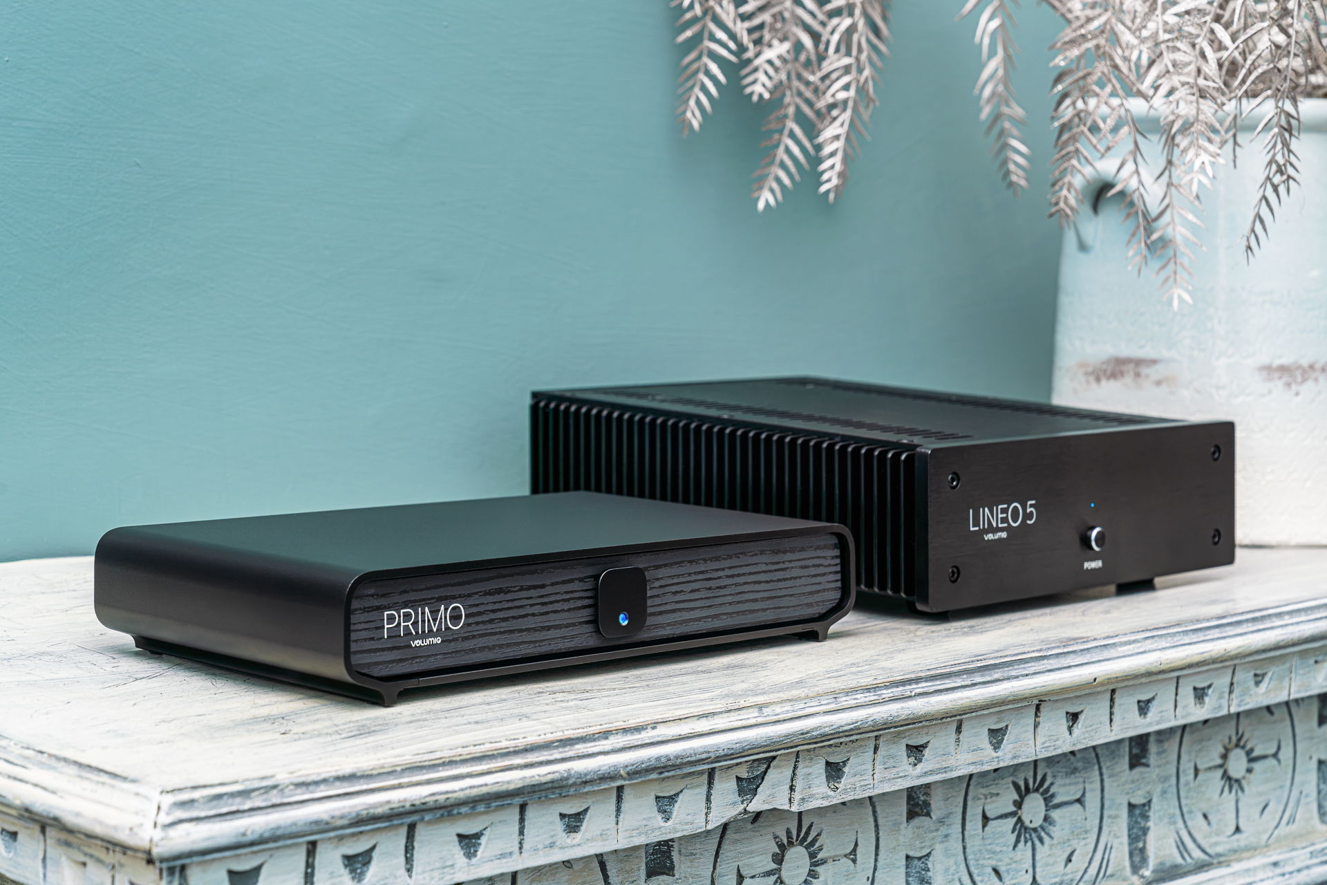

Primo V3 is designed and made in Florence.
Made in Florence
Assembled by hand, in Italy

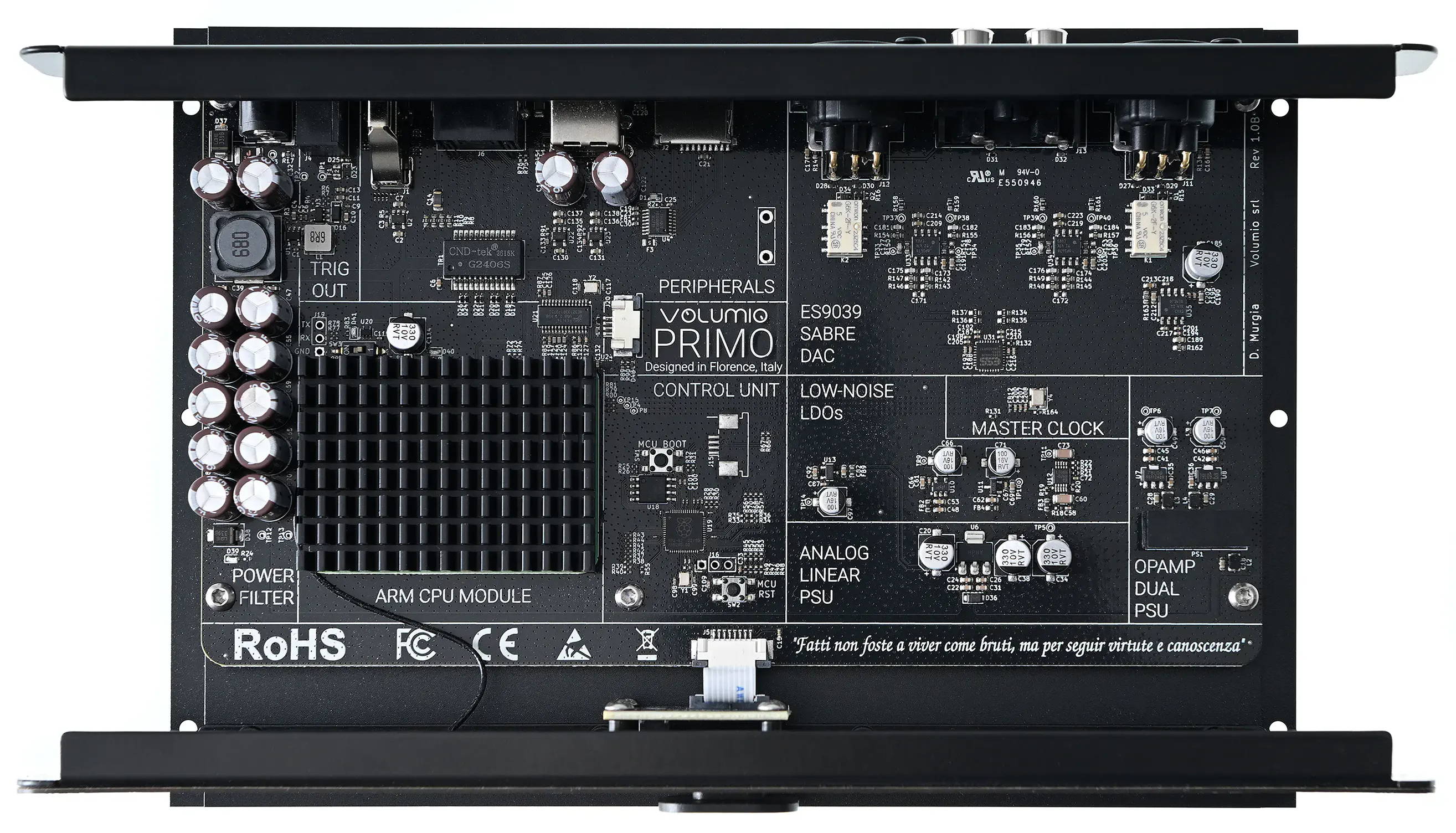

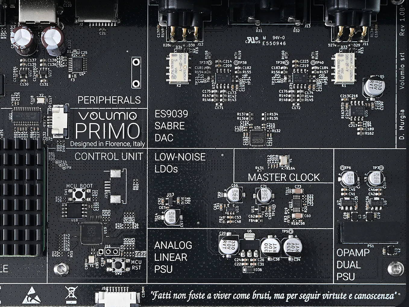

Primo V3 is designed in Florence and assembled there by hand, by the team that also writes its software. Each unit is checked before it leaves the lab.
More about Volumio in FlorenceLook inside

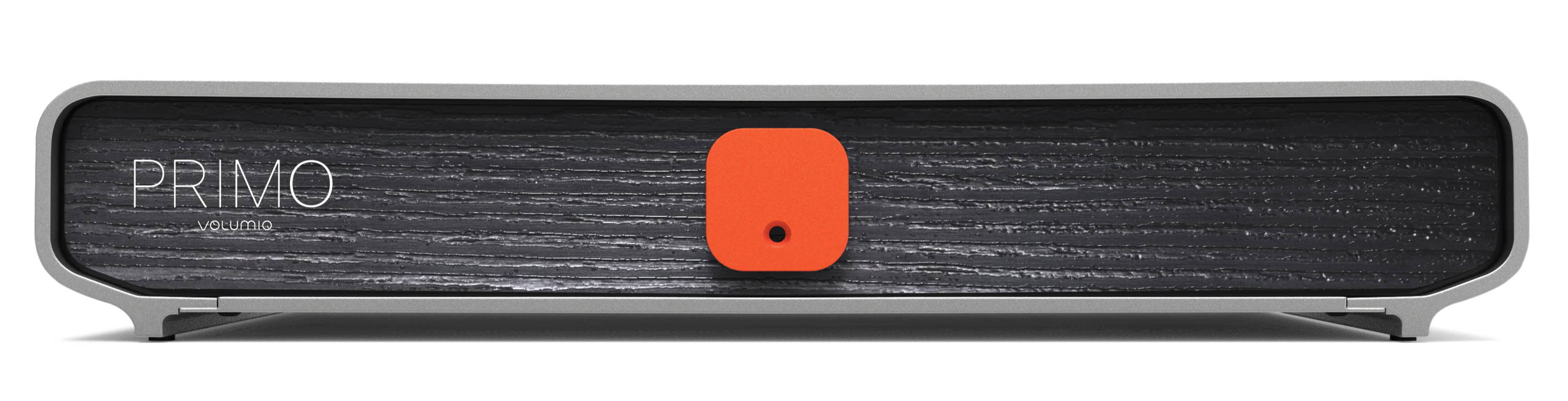

Engineered for sound
Primo V3 is a complete redesign of the original Primo. A linear power supply stage and a high-precision clock keep noise and jitter low, and the layout keeps every current path short. Along the edge sits a hidden nod to Florence. Pick a part to find it on the board.

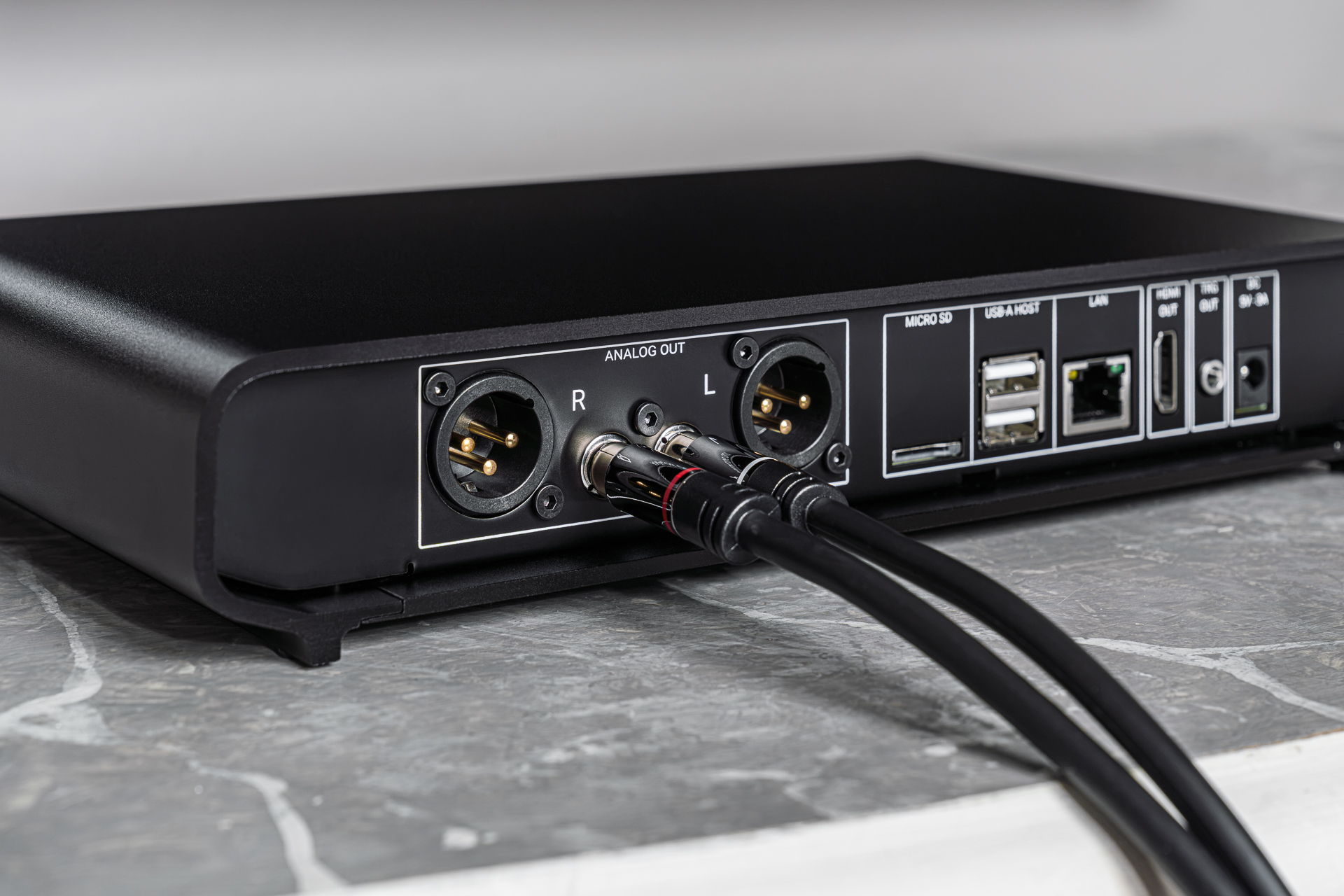

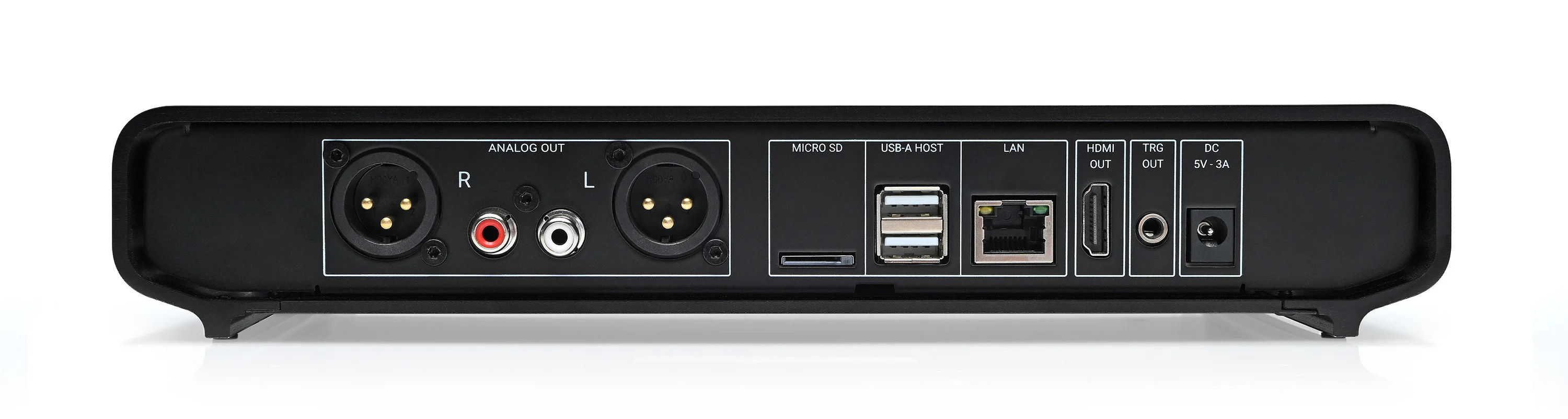

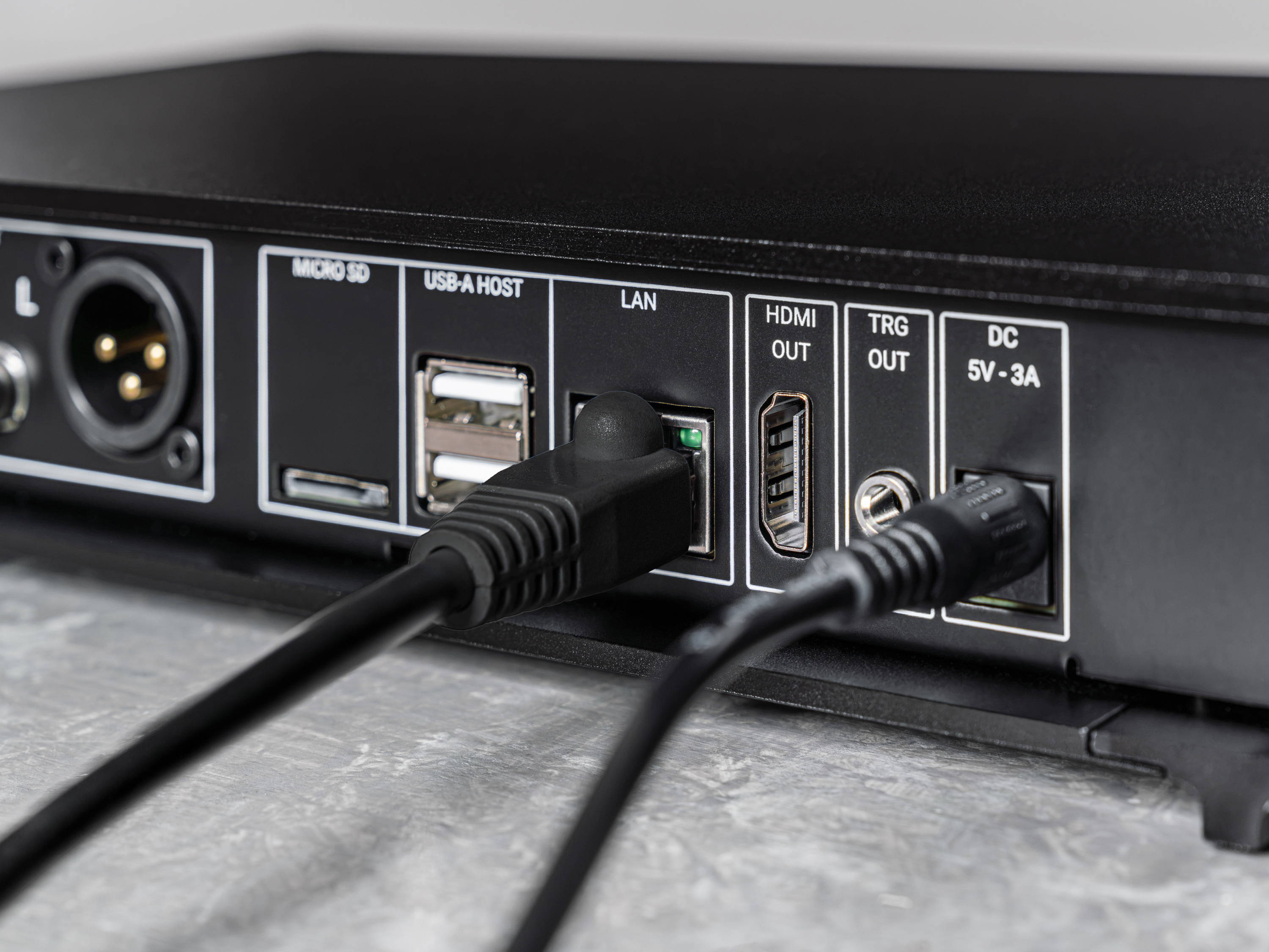

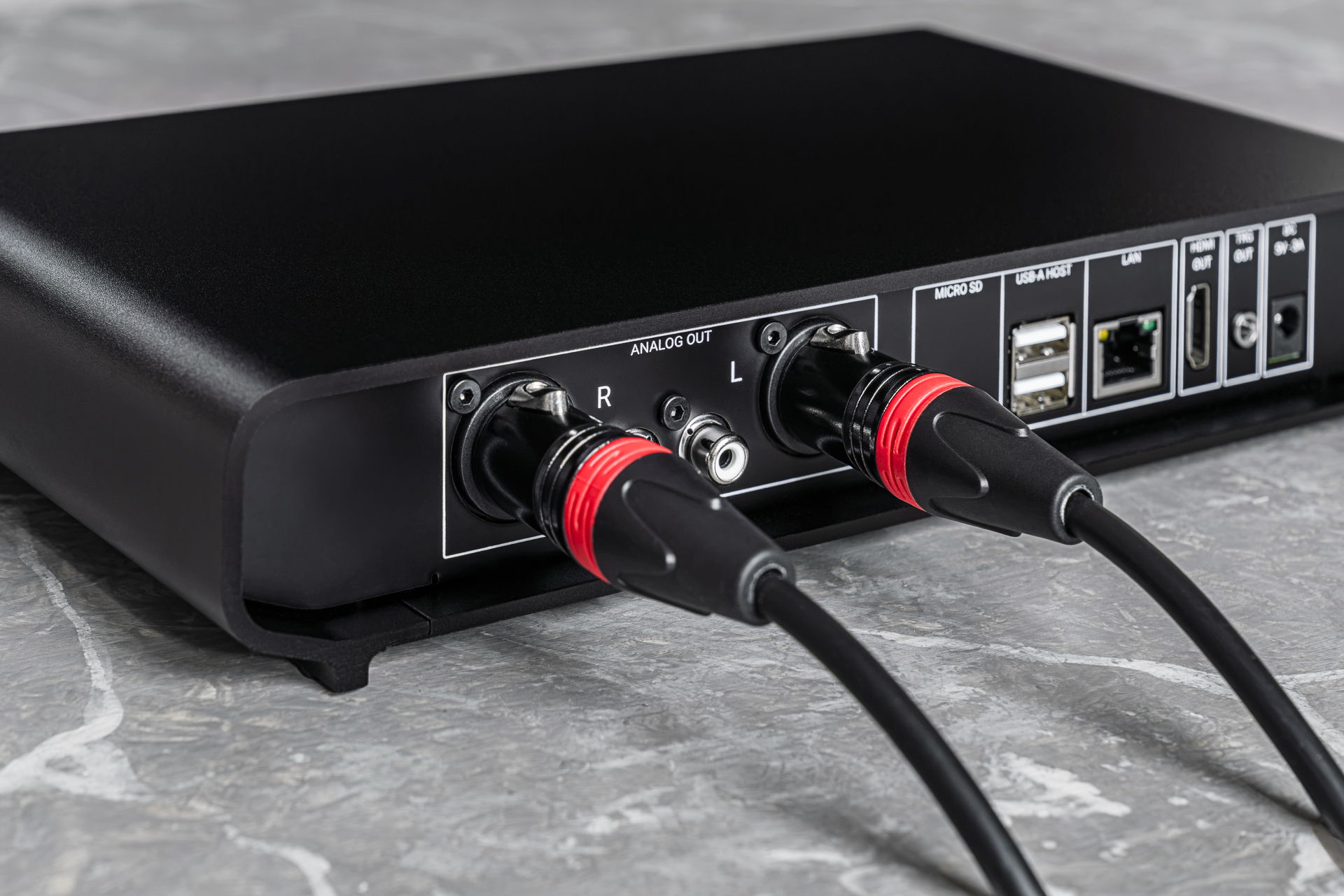

Connections
Network in. Analog out.
Stream over Gigabit Ethernet or dual-band Wi-Fi. Then send the signal out balanced or unbalanced, or to a USB DAC.
In
- Ethernet
- Gigabit, 10/100/1000
- Wi-Fi
- 802.11a/b/g/n/ac, 2.4 and 5 GHz
- Bluetooth
- Bluetooth 5.0
- Power
- 5 V DC / 3 A, on a 5.5 × 2.1 mm barrel jack
Out
- Analog balanced
- XLR, 1.00 to 6.30 Vrms in 8 levels
- Analog unbalanced
- RCA, 0.50 to 3.15 Vrms in 8 levels
- USB-A × 2
- To a USB DAC, up to PCM 1536 kHz / 32-bit and DSD1024, with multiroom off
- HDMI
- Mirrors the Volumio app on your TV, up to 4K at 60 fps
- Trigger out
- 12 V on a 3.5 mm jack, positive on tip

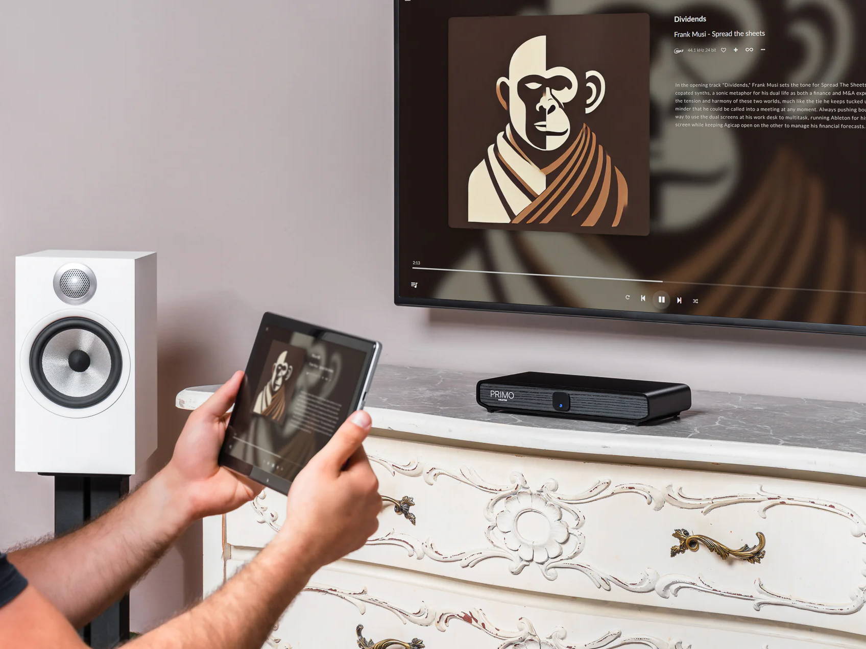

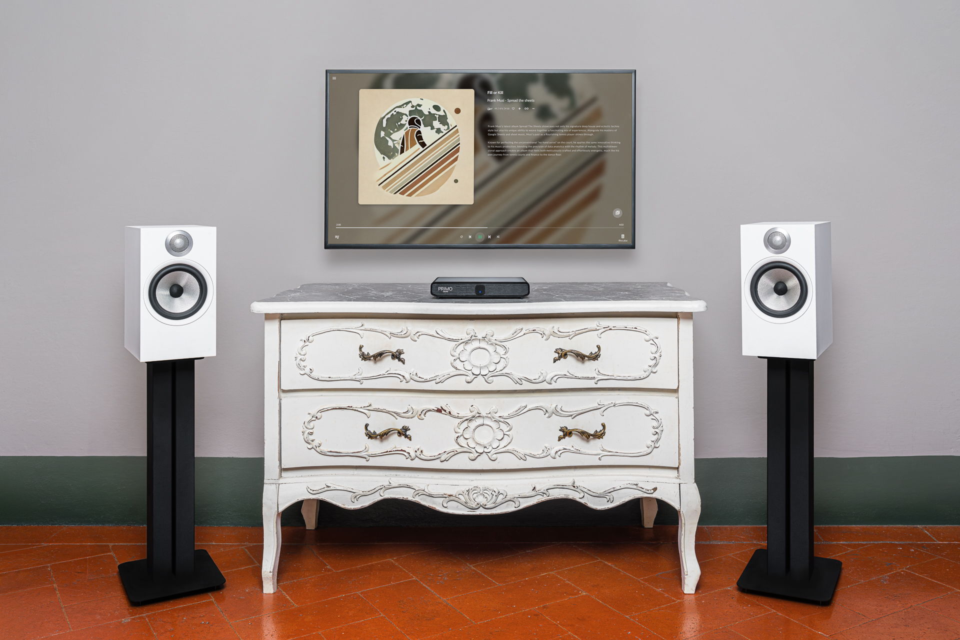

On your TV
Connect HDMI and browse your music on the big screen, in up to 4K at 60 fps.
In your hand
Browse, play and control it all from the Volumio app, in lossless and high resolution.

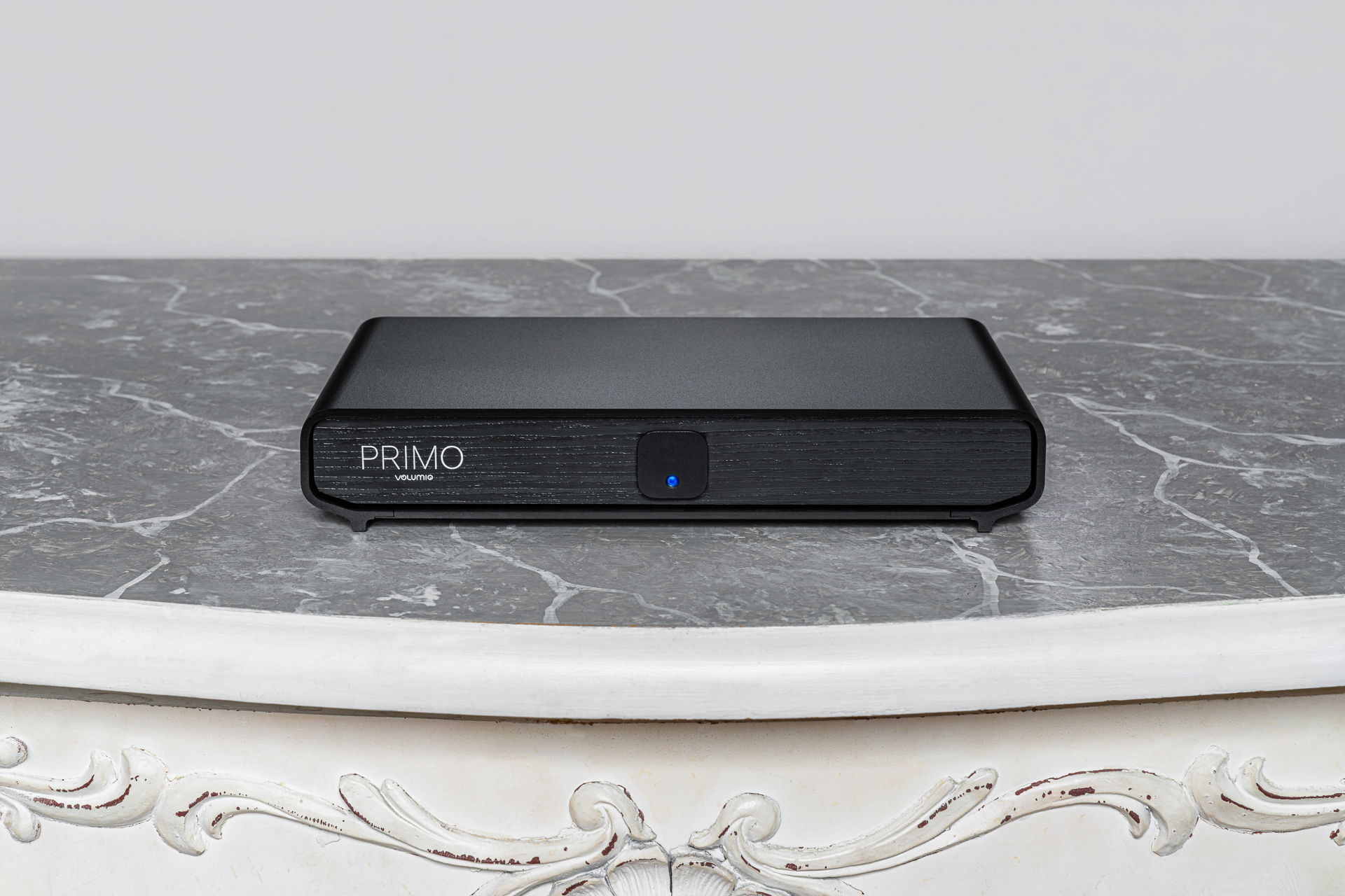

- Dimensions
- 27 × 15 × 5.2 cm (10.6 × 5.9 × 2.0 in)
- Weight
- 1.12 kg (2.47 lb)

Progettato per il suono
Primo V3 è una riprogettazione completa del Primo originale. Uno stadio di alimentazione lineare e un clock ad alta precisione mantengono bassi rumore e jitter, e il layout tiene corti tutti i percorsi di corrente. Lungo il bordo si nasconde un omaggio a Firenze. Scegli un componente per trovarlo sulla scheda.

Connessioni
In ingresso, la rete. In uscita, l'analogico.
Ascolta in streaming via Gigabit Ethernet o Wi-Fi dual band, poi manda il segnale in uscita, bilanciato o sbilanciato, oppure a un DAC USB.
Ingressi
- Ethernet
- Wi-Fi
- 802.11a/b/g/n/ac, 2,4 e 5 GHz
- Bluetooth
- Bluetooth 5.0
- Alimentazione
- 5 V DC / 3 A, su spinotto DC da 5,5 × 2,1 mm
Uscite
- Analogica bilanciata
- XLR, da 1,00 a 6,30 Vrms in 8 livelli
- Analogica sbilanciata
- RCA, da 0,50 a 3,15 Vrms in 8 livelli
- USB-A × 2
- Verso un DAC USB, fino a PCM 1536 kHz / 32-bit e DSD1024, con multiroom disattivato
- HDMI
- Mostra l'app Volumio sulla tua TV, fino a 4K a 60 fps
- Uscita trigger
- 12 V su jack da 3,5 mm, positivo sulla punta

Specifiche hardware di Primo V3
- USB
- 2 × USB-A 2.0 (5 V / 0,56 A; 5 V / 1,33 A)
- Uscita analogica bilanciata
- 1 × XLR (stereo)
- Uscita analogica sbilanciata
- 1 × RCA (stereo)
- Uscita video
- Mirroring dell'app Volumio OS via HDMI fino a 4K / 60 fps
- LAN
- Gigabit 10/100/1000 Mbps
- Wi-Fi
- Wi-Fi 802.11a/b/g/n/ac, 2,4 GHz e 5 GHz
- Bluetooth
- 5.0
- CPU
- ARM Cortex-A72, Quad Core 1,5 GHz
- RAM
- 2 GB DDR4
- Archiviazione interna
- 16 GB eMMC
- Uscita trigger
- 1 × jack da 3,5 mm (12 V, positivo sulla punta)
- Alimentazione
- 5 V DC / 3 A
- Ingresso di alimentazione
- Spinotto DC 5,5 × 2,1 mm (positivo al centro)

Conçu pour le son
Le Primo V3 est une refonte complète du Primo d’origine. Un étage d’alimentation linéaire et une horloge de haute précision maintiennent le bruit et la gigue à un niveau bas, et l’implantation raccourcit chaque chemin de courant. Le long du bord se cache un clin d’œil à Florence. Choisissez un composant pour le situer sur la carte.

Connectique
Réseau en entrée. Analogique en sortie.
Diffusez en Gigabit Ethernet ou en Wi-Fi double bande. Puis envoyez le signal en symétrique ou en asymétrique, ou vers un DAC USB.
Entrées
- Ethernet
- Wi-Fi
- 802.11a/b/g/n/ac, 2,4 et 5 GHz
- Bluetooth
- Bluetooth 5.0
- Alimentation
- 5 V DC / 3 A, sur connecteur DC 5,5 × 2,1 mm
Sorties
- Analogique symétrique
- XLR, de 1,00 à 6,30 Vrms en 8 niveaux
- Analogique asymétrique
- RCA, de 0,50 à 3,15 Vrms en 8 niveaux
- USB-A × 2
- Vers un DAC USB, jusqu’à PCM 1536 kHz / 32-bit et DSD1024, multiroom désactivé
- HDMI
- Recopie l’application Volumio sur votre téléviseur, jusqu’en 4K à 60 fps
- Sortie trigger
- 12 V sur jack 3,5 mm, positif sur la pointe

Diseñado para el sonido
Primo V3 es un rediseño completo del Primo original. Una etapa de alimentación lineal y un reloj de alta precisión mantienen bajos el ruido y el jitter, y el diseño de la placa acorta todas las rutas de corriente. En el borde se esconde un guiño a Florencia. Elige un componente para localizarlo en la placa.

Conexiones
Entrada de red. Salida analógica.
Reproduce por streaming con Gigabit Ethernet o wifi de doble banda. Después envía la señal en balanceado o en no balanceado, o a un DAC USB.
Entradas
- Ethernet
- Wi-Fi
- 802.11a/b/g/n/ac, 2,4 y 5 GHz
- Bluetooth
- Bluetooth 5.0
- Alimentación
- 5 V DC / 3 A, con conector de barril de 5,5 × 2,1 mm
Salidas
- Analógica balanceada
- XLR, de 1,00 a 6,30 Vrms en 8 niveles
- Analógica no balanceada
- RCA, de 0,50 a 3,15 Vrms en 8 niveles
- USB-A × 2
- A un DAC USB, hasta PCM 1536 kHz / 32-bit y DSD1024, con el multiroom desactivado
- HDMI
- Duplica la app de Volumio en tu televisor, hasta 4K a 60 fps
- Salida de trigger
- 12 V en una toma de 3,5 mm, con el positivo en la punta

En tu televisor
Conecta el HDMI y explora tu música en la pantalla grande, hasta en 4K a 60 fps.
En tu mano
Explora, reproduce y contrólalo todo desde la app de Volumio, sin pérdidas y en alta resolución.

- USB
- Salida analógica balanceada
- 1 × XLR (estéreo)
- Salida analógica no balanceada
- 1 × RCA (estéreo)
- Salida de vídeo
- Duplicado de la app de Volumio OS por HDMI hasta 4K / 60 fps
- LAN
- Wi-Fi
- Wi-Fi 802.11a/b/g/n/ac, 2,4 GHz y 5 GHz
- Bluetooth
- 5.0
- CPU
- ARM Cortex-A72, cuatro núcleos a 1,5 GHz
- RAM
- 2 GB DDR4
- Almacenamiento interno
- 16 GB eMMC
- Salida de trigger
- 1 × toma de 3,5 mm (12 V, positivo en la punta)
- Alimentación
- 5 V DC / 3 A
- Entrada de alimentación
- Conector de barril de 5,5 × 2,1 mm (polaridad positiva)
