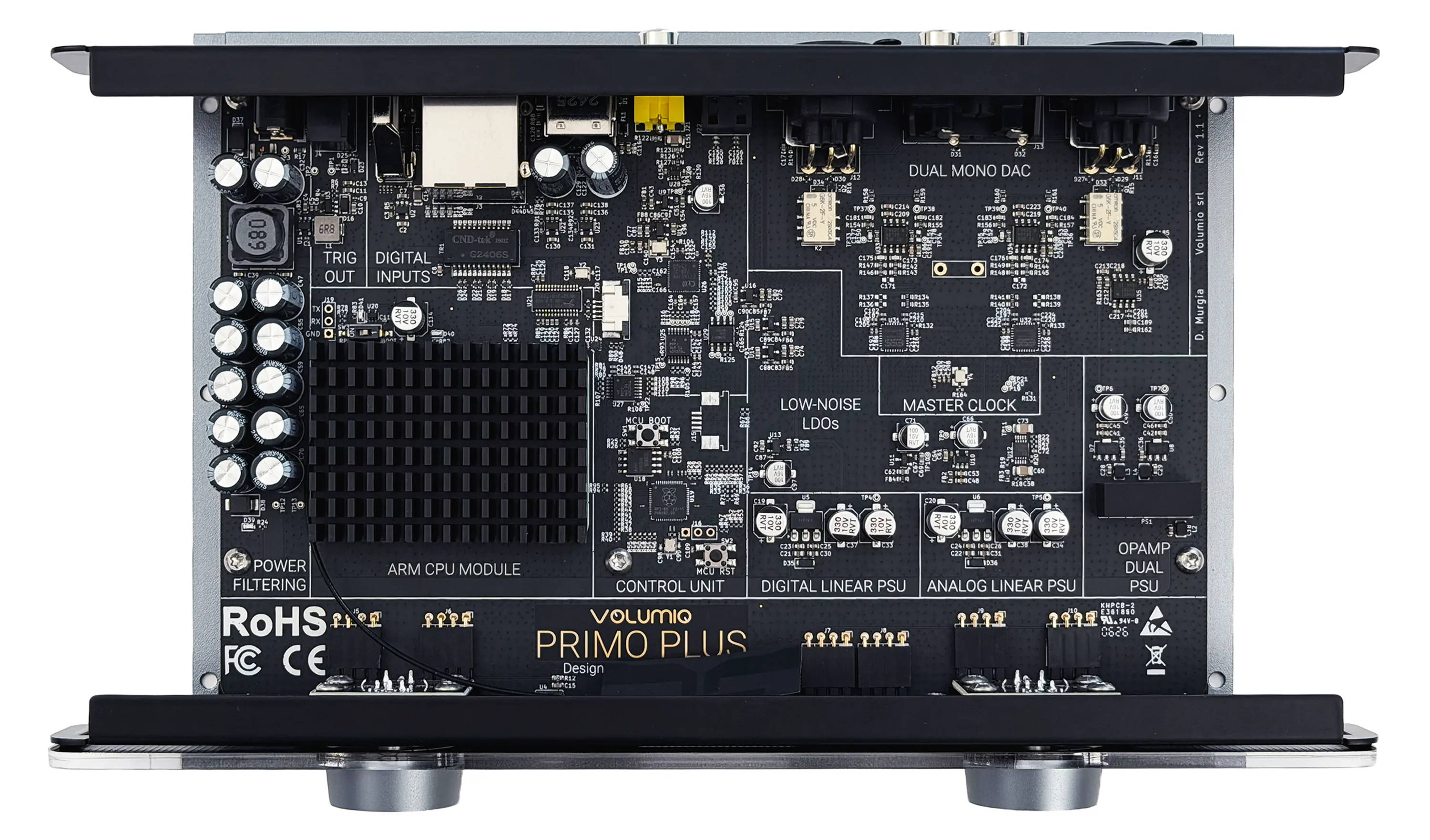

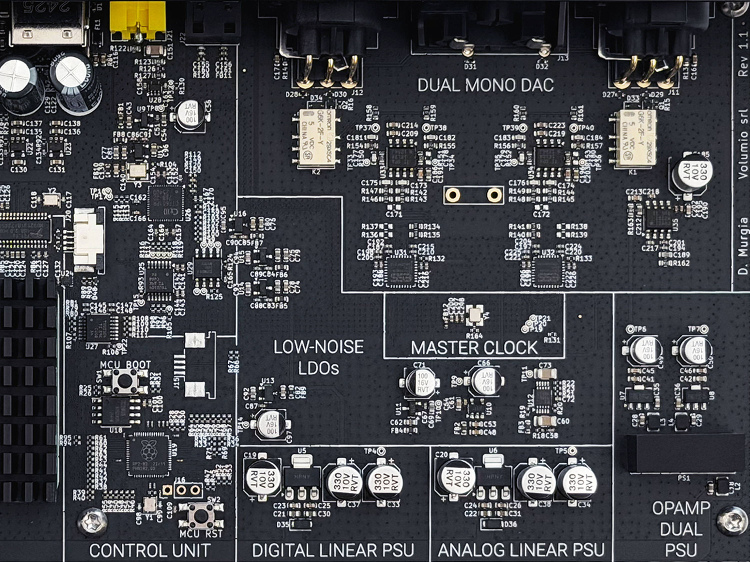

Every part has a job
Primo Plus was designed from scratch around cleaner power, lower noise and a more precise clock. Pick a part to find it on the board.

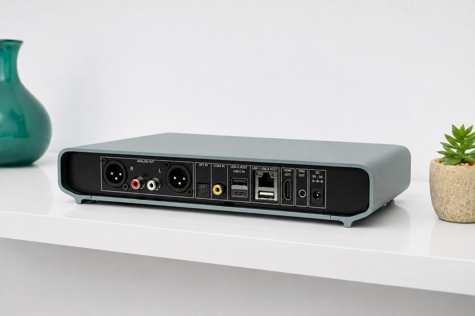

Connections
Plug in everything
Stream over the network, or connect a computer, a TV, a CD drive or a hard disk. Then send the signal out balanced or unbalanced.
In
- Network
- Gigabit Ethernet or dual-band Wi-Fi
- USB-C
- From a computer, up to PCM 768 kHz / 32-bit and DSD512
- S/PDIF coaxial and optical
- RCA and TOSLINK, up to PCM 192 kHz / 24-bit
- USB-A × 2
- Flash drives, hard disks and CD drives
- Bluetooth
- Bluetooth 5.0
Out
- Balanced
- XLR, 1.00 to 6.30 Vrms
- Unbalanced
- RCA, 0.50 to 3.15 Vrms
- USB
- To an external DAC, up to PCM 1536 kHz / 32-bit and DSD1024, with multiroom off
- HDMI
- The Volumio interface on your TV, up to 4K at 60 fps
- Trigger
- 12 V on a 3.5 mm jack, to switch your amplifier on

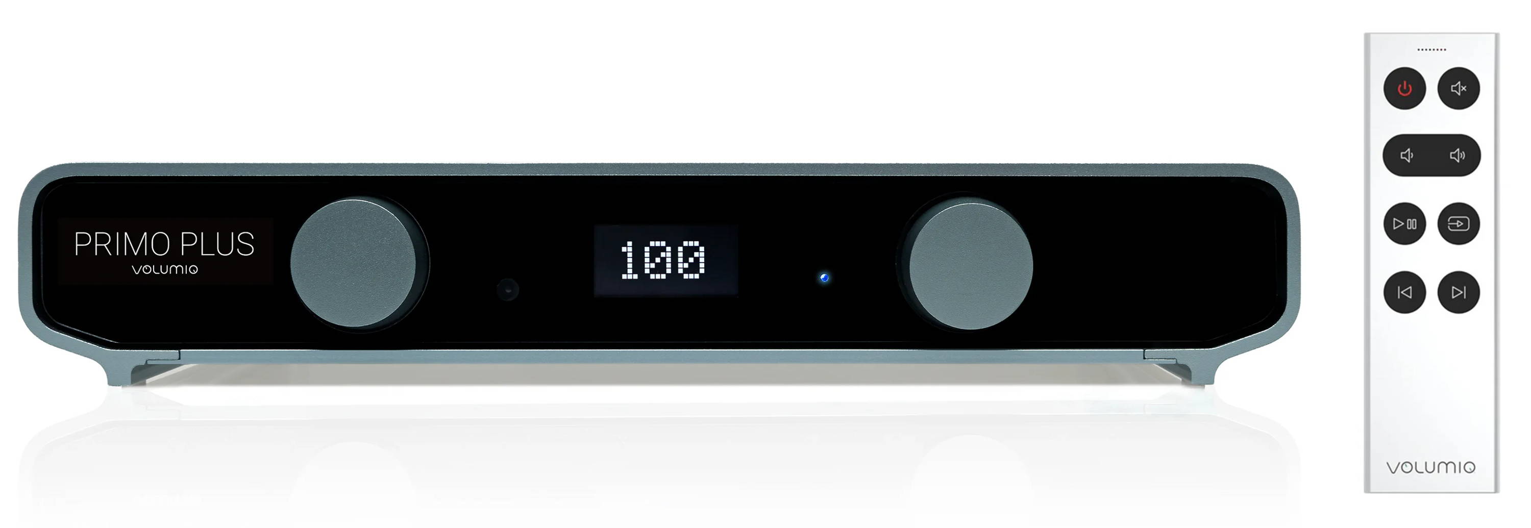

In your hand
Use the Remoto remote that comes in the box, or the two knobs and the OLED display on the front.

- Master clock
- High-precision clock with ultra-low phase noise (90 fs) and jitter
- Preamp mode
- Hardware, volume set from the knob, the app or Remoto, to drive power amps directly
- Power supply
- LC filtering and dual linear stage with dedicated line regulators for analog and digital paths

Ogni componente ha un compito
Primo Plus è stato progettato da zero attorno a un'alimentazione più pulita, a un rumore più basso e a un clock più preciso. Scegli un componente per trovarlo sulla scheda.

Ascolta in streaming dalla rete, oppure collega un computer, una TV, un lettore CD o un hard disk. Poi manda il segnale in uscita, bilanciato o sbilanciato.
Ingressi
- Rete
- Gigabit Ethernet o Wi-Fi dual band
- USB-C
- Da un computer, fino a PCM 768 kHz / 32-bit e DSD512
- S/PDIF coassiale e ottico
- RCA e TOSLINK, fino a PCM 192 kHz / 24-bit
- USB-A × 2
- Chiavette USB, hard disk e lettori CD
- Bluetooth
- Bluetooth 5.0
Uscite
- Bilanciata
- XLR, da 1,00 a 6,30 Vrms
- Sbilanciata
- RCA, da 0,50 a 3,15 Vrms
- USB
- Verso un DAC esterno, fino a PCM 1536 kHz / 32-bit e DSD1024, con multiroom disattivato
- HDMI
- L'interfaccia Volumio sulla tua TV, fino a 4K a 60 fps
- Trigger
- 12 V su jack da 3,5 mm, per accendere il tuo amplificatore

- DAC
- 2 × ESS Sabre ES9039Q2M
- Filtri DAC
- 8 filtri digitali per la messa a punto
- Risoluzione supportata
- Fino a PCM 768 kHz / 32 bit e DSD512
- Modalità NOS
- Attivabile e disattivabile
- Master clock
- Clock ad alta precisione con rumore di fase (90 fs) e jitter bassissimi
- Modalità preamplificatore
- Hardware, volume regolato dalla manopola, dall'app o da Remoto, per pilotare direttamente i finali di potenza
- Alimentatore
- Filtraggio LC e stadio lineare doppio con regolatori di linea dedicati per i percorsi analogico e digitale

Specifiche hardware
- USB
- 1 × USB-C device, 2 × USB-A host (5 V / 0,56 A; 5 V / 1,33 A)
- Ingresso S/PDIF coassiale
- 1 × RCA
- Ingresso S/PDIF ottico
- 1 × TOSLINK
- Uscita analogica bilanciata
- 1 × XLR (stereo)
- Uscita analogica sbilanciata
- 1 × RCA (stereo)
- Uscita video
- Mirroring dell'app Volumio OS via HDMI fino a 4K / 60 fps
- LAN
- Gigabit 10/100/1000 Mbps
- Wi-Fi
- Wi-Fi 802.11a/b/g/n/ac, 2,4 GHz e 5 GHz
- Bluetooth
- 5.0
- CPU
- ARM Cortex-A72, Quad Core 1,5 GHz
- RAM
- 2 GB DDR4
- Archiviazione interna
- 16 GB eMMC
- Uscita trigger
- 1 × jack da 3,5 mm (12 V, positivo sulla punta)

- Filtrado LC y etapa lineal doble con reguladores de línea dedicados para las rutas analógica y digital

- Entrada S/PDIF coaxial
- 1 × RCA
- Entrada S/PDIF óptica
- 1 × TOSLINK
- Salida analógica balanceada
- 1 × XLR (estéreo)
- Salida analógica no balanceada
- 1 × RCA (estéreo)
