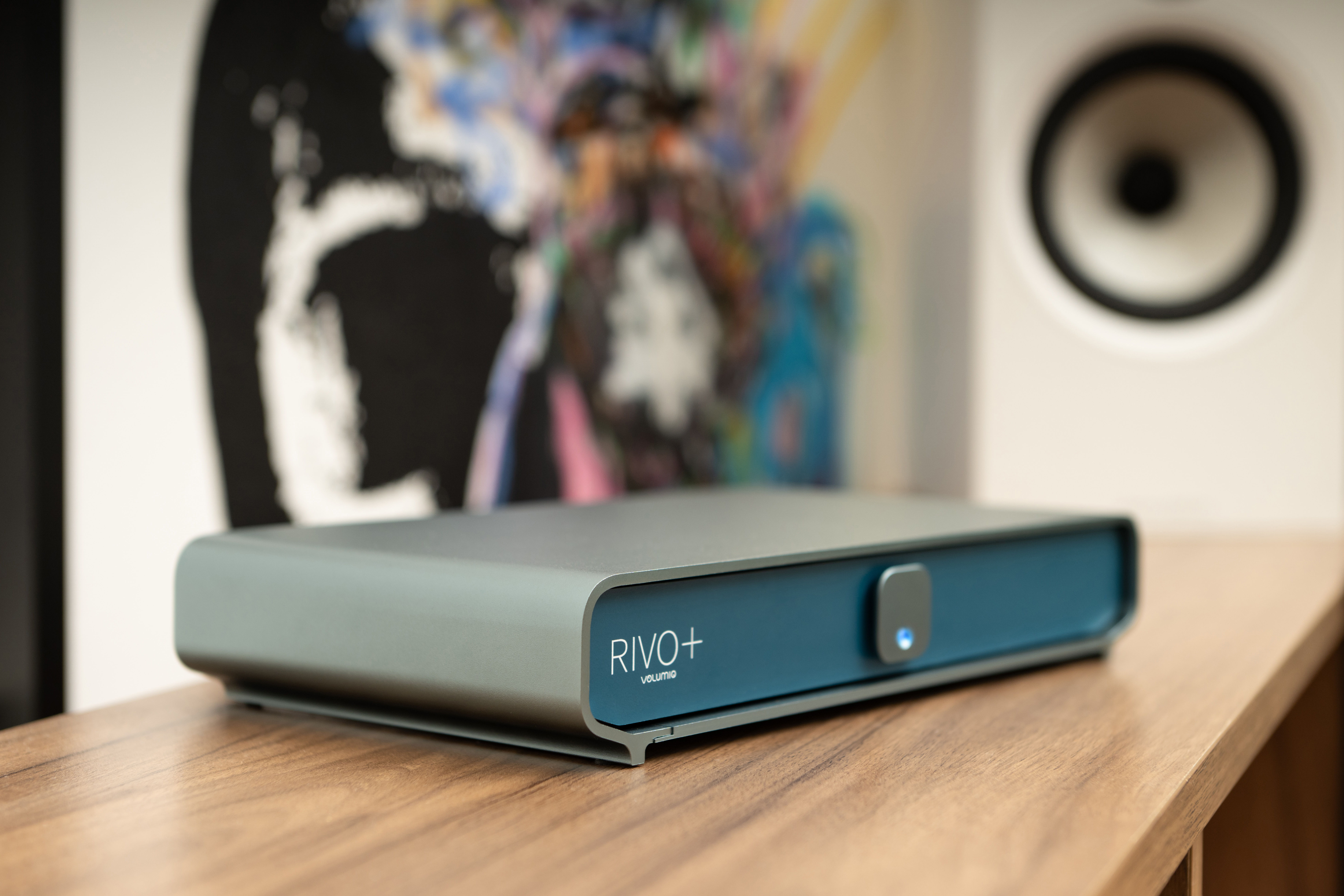

Cleaner outputs. Steadier clocks.
Rivo Plus is the enhanced version of Rivo, engineered from what listeners asked for. A dedicated ASIC now generates the S/PDIF coaxial and AES/EBU signals, and improved MEMS clocks lower jitter.
A dedicated ASIC
An ASIC is a chip built for one task. Here it generates the S/PDIF coaxial and AES/EBU output signals. This takes the job off the main processor, so its interference and jitter stay out of these outputs.
A MEMS clock and quiet power
A high-quality MEMS (micro-electro-mechanical systems) clock drives the ASIC and gives it a very stable, low-jitter timing reference. Low-noise voltage regulators power it.
Reclocked USB
An upgraded MEMS clock in the USB hub chip improves reclocking and signal integrity, above all on the USB DAC output. It keeps jitter low and the frequency stable, with less drift from temperature changes and aging.

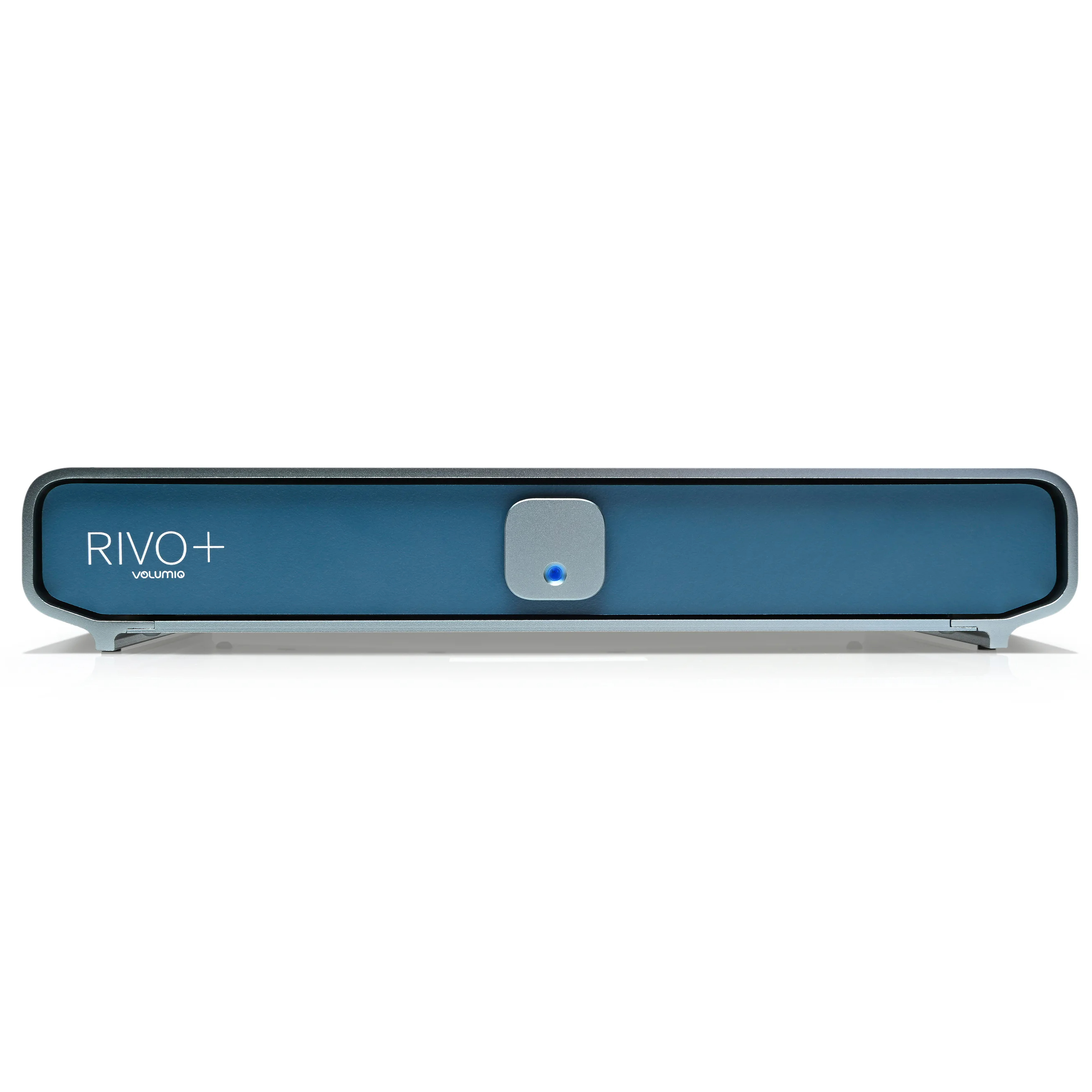

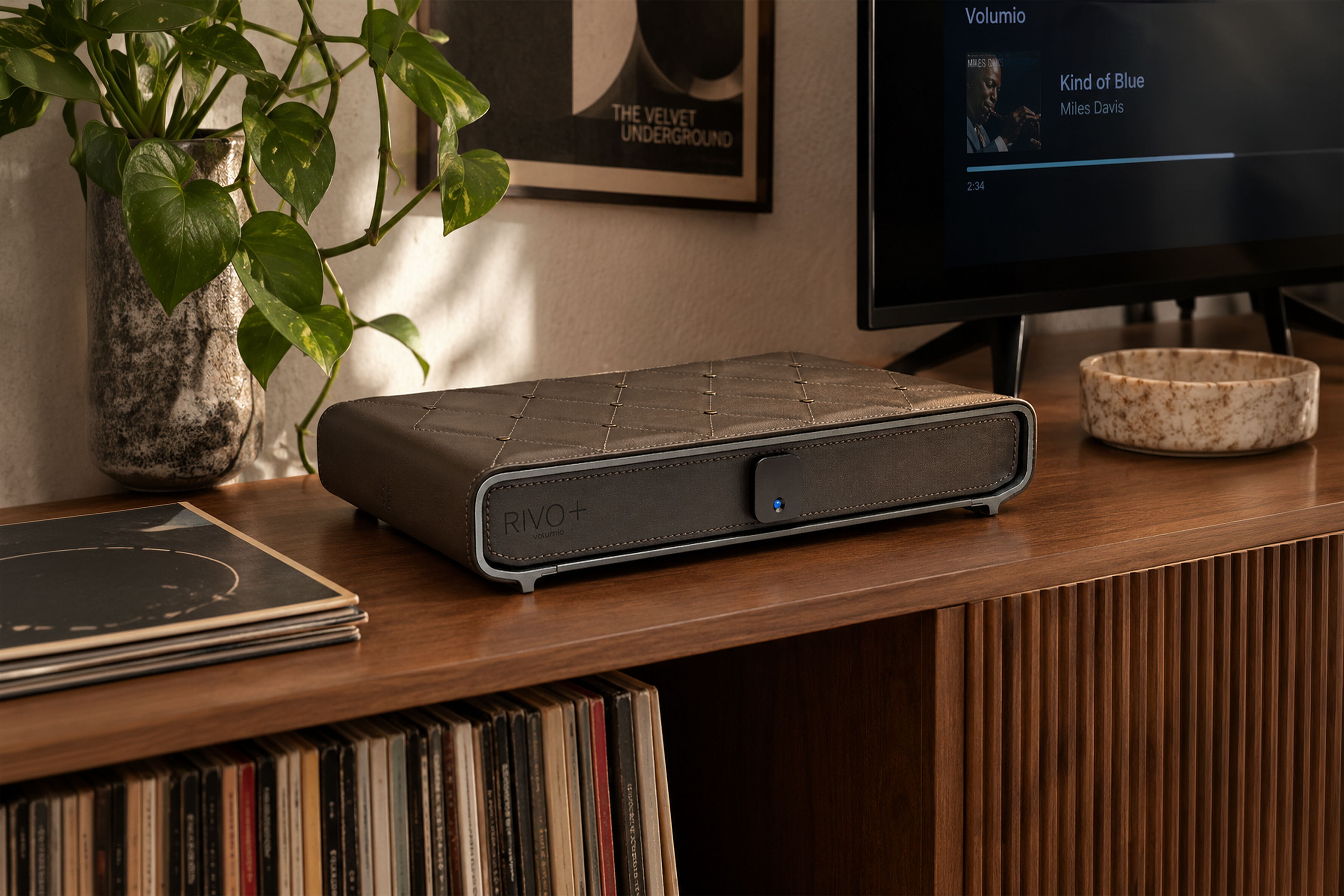

Rivo Plus comes in two finishes. The Special Edition has a refined brown leather finish, inspired by Italian craftsmanship.
Classic
A deep blue front with a square button, in a grey case.
Special Edition
Brown leather on the front, and a diamond-stitched leather top.

Classic
Un frontal azul intenso con un botón cuadrado, en una caja gris.
Special Edition
Piel marrón en el frontal y una cubierta de piel con pespunte de rombos.
